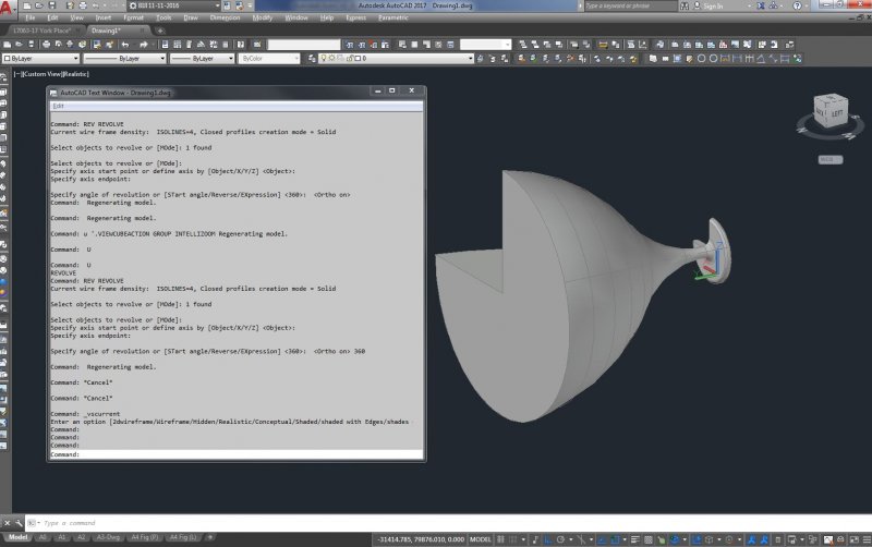

Dadgad Posted August 2, 2017 Posted August 2, 2017 Are you using the REVOLVE command for Modeling? Could you attach a screenshot of your commandline history, as you experience this anomaly? Quote

ReMark Posted August 2, 2017 Posted August 2, 2017 I tested your profile using AutoCAD 2017. I was able to fully revolve it 360 degrees (the default). Is the object supposed to be a goblet/wine glass by any chance? Quote
BIJI SAMUEL Posted August 2, 2017 Author Posted August 2, 2017 I tested your profile using AutoCAD 2017. I was able to fully revolve it 360 degrees (the default). Is the object supposed to be a goblet/wine glass by any chance? This is just an example i created. Its not the part of my work. I still believe that some sort of settings has been changed. Quote
ReMark Posted August 2, 2017 Posted August 2, 2017 The only "setting" is right there on the command line unless you pay no attention to it and randomly click somewhere in model space. When in doubt key in the exact degree of rotation. Guessing or eyeballing the degree of rotation is not a good habit to get into. Quote
