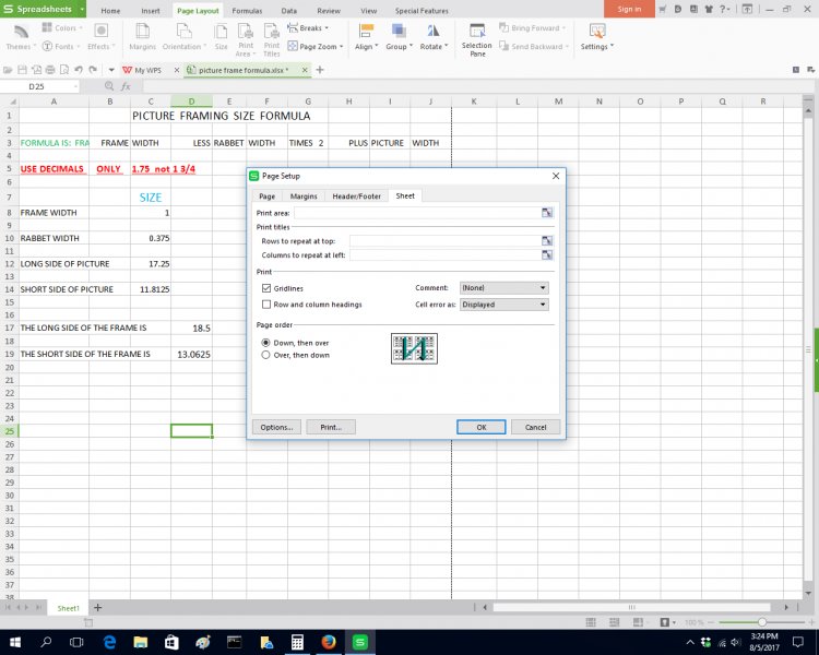

I may be reading your problem all wrong but could it that print grid lines is turned on in Excel?
That's ok, thanks for the reply. Yes, I made sure that the print grid lines were all turned off in Excel prior to exporting/generating the pdf. The pdf is fine, wherever it is opened up, i.e Photoshop, Illustrator, Acrobat, etc., but when the pdf import is used in AutoCAD, no matter how I change the import settings, the extra horizontal lines are there.
