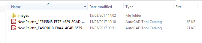

I have a tool palet instollation file with images . the file format type is .atc
How can I import tool palet with this file. ( The uploading of this file not allowed by cadtutor system.

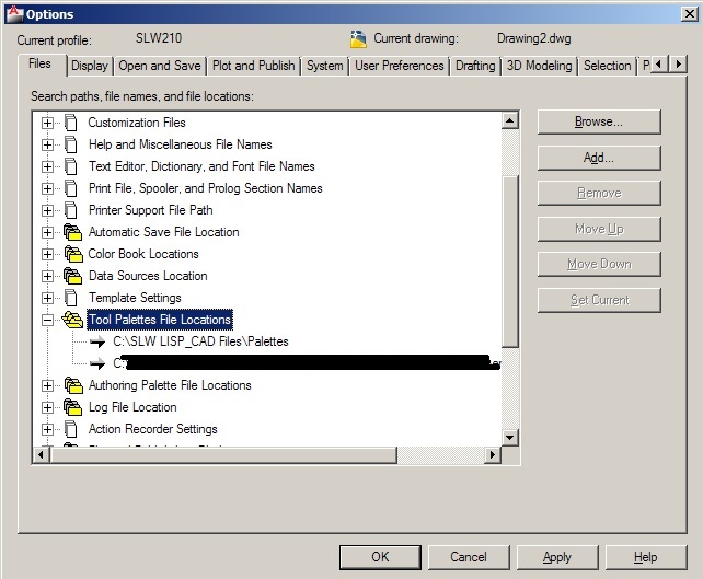

Just add the folder location to Options>Files>Tool Palletes File Locations. If not from the same AutoCAD Version, they may not work correctly.
Thanks it is a good idea.
