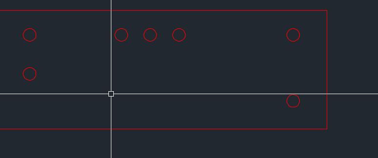

No it was done purposely to not use array command rather a simplified version of copying an object in x & y directions you can do 1x40 copy 1 object +40 in X direction. It would be used by people who stuff like bolt holes in patterns, it will work on angles as well, provided you set the ucs.
Something like this starting with bottom right circle, 1y100 copy up, L copy across 1x-100 L then 3x-50 L 1x-100 L 1y-50
Using the L LAST and Enter key is a fast way of repeating using an object like a circle.
