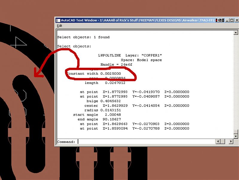

These polylines are only .002" wide, 1/4 what an 8 mil line would be. It's not that the lines are too small to see that's preventing the visibility.

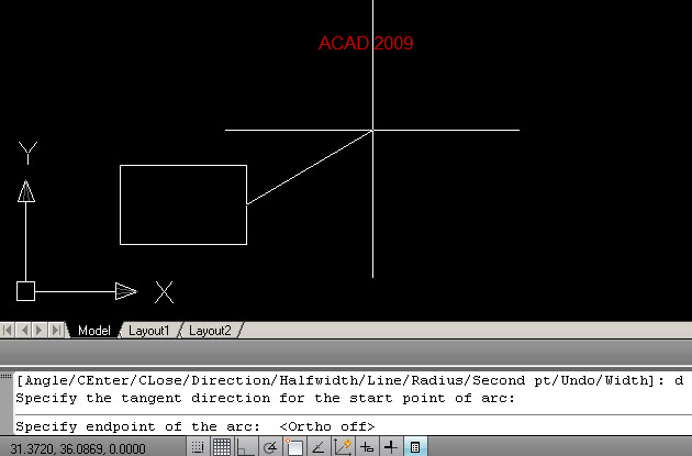

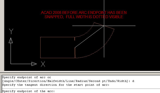

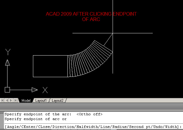

Dragmode is set to in both ACAD 2008 and ACAD 2009. These screen captures show how, in 2008, the pline width is "previewed" while in 2009 it is not. Note that in these tests, the final arc endpoint has not been snapped yet. In 2009, once you snap the arc endpoint, then and only then does the pline arc appear. This is useless for anyone doing electronic layout. Any ideas out there?
