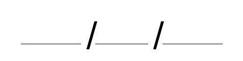

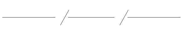

harrydang Posted September 12, 2017 Posted September 12, 2017 Hello guys, I working on AutoCAD 2010. And for some reasons, some line types have changed as shown in the attachments (linetype scale, lineweight, and thickness are not changed). Could you please tell me why and how to fix this issue? Much appreciated! Quote

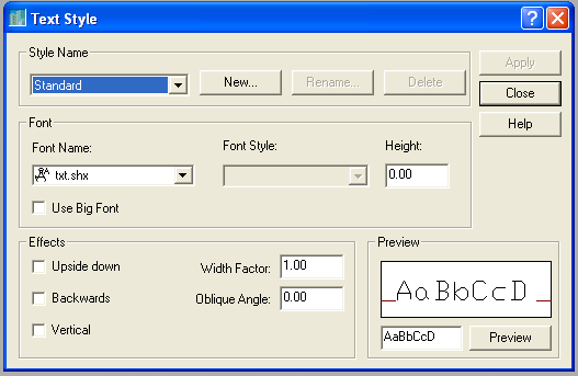

eldon Posted September 12, 2017 Posted September 12, 2017 These linetypes use a letter in their definition. These letters have a Textstyle associated with them. For ease of use, the textstyle used is usually Standard, because it automatically exists in every drawing. My thoughts are that the Standard textstyle has got different fonts in your drawings. Change to a common font and your linetypes will appear the same. Quote

eldon Posted September 13, 2017 Posted September 13, 2017 Hi Eldon, Thanks for getting back to me. These linetypes are created as standards (?) and I just copied and pasted for convenient use. I also bring some blocks from other drawings into mine. Before doing that, I purged all the items, which I guess causes a conflict between two drawings. I have changed all the textstyle (text and Mtext) to standard but it does not help. Would there be anything I overlooked? Thank you The actual font used for the Standard textstyle is all important. Each individual font has its own points of insertion for the different characters. So in the linetype definition, the x and y factors only apply to the font used, and will be different for a different font. Go into the Text Style manager and see what font name has been used, and make these the same for both drawings. Blocks have no effect and purging has no effect, but the specific font used for the Standard Text Style does have effect. If you want to use a different font, then you will have to edit the linetype definition file. Quote
harrydang Posted September 14, 2017 Author Posted September 14, 2017 The actual font used for the Standard textstyle is all important. Each individual font has its own points of insertion for the different characters. So in the linetype definition, the x and y factors only apply to the font used, and will be different for a different font. Go into the Text Style manager and see what font name has been used, and make these the same for both drawings. Blocks have no effect and purging has no effect, but the specific font used for the Standard Text Style does have effect. If you want to use a different font, then you will have to edit the linetype definition file. Finally, I am with you now. I have changed text height to 2.5 (meant to be 0.00). Now, everything comes back to normal. Thank you so much Eldon Quote
