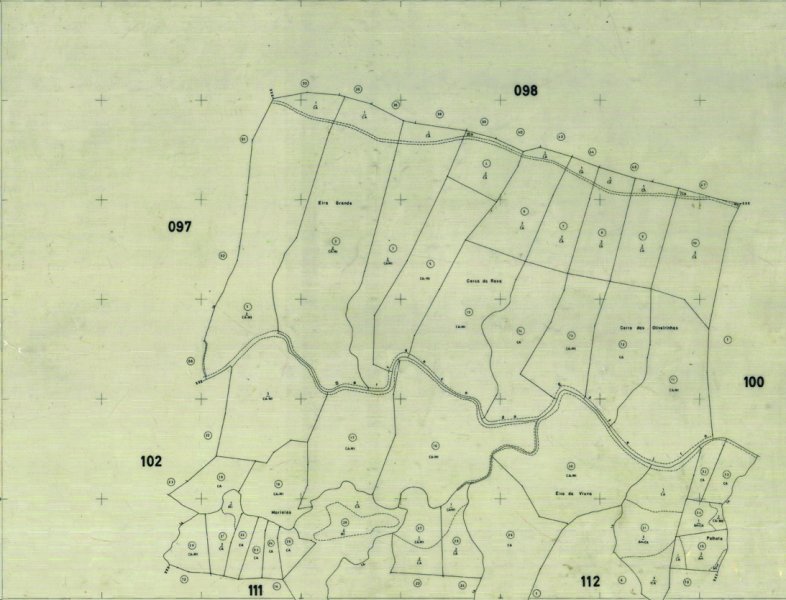

Is it possible, and if it is, wich is the best way to transform an image to CAD?
The image is this one, and ia wanto to capture to CAD, lines, points, letters, numbers, etc.
Best way is to import and trace. There's also Raster Design that can do a lot of legwork up front.
you need to look at WiseImage PRO from CSoft. www.csoft.com with this you will be able to recalibrate the grid to. Check this video
