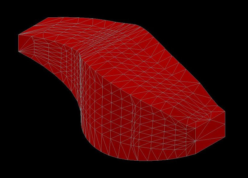

ReMark Posted September 22, 2017 Posted September 22, 2017 I know of a routine that will convert a solid to either 3Dmeshes or 3Dfaces. Would that be of any use? Here is an image of a solid that I converted using the routine. BTW...welcome back fuccaro. Quote

ReMark Posted September 22, 2017 Posted September 22, 2017 Nobody suggested exploding a solid. We're talking a straight conversion from solid to triangular faces or at least that is my interpretation which is what I believe I show in the image previously posted. Quote
