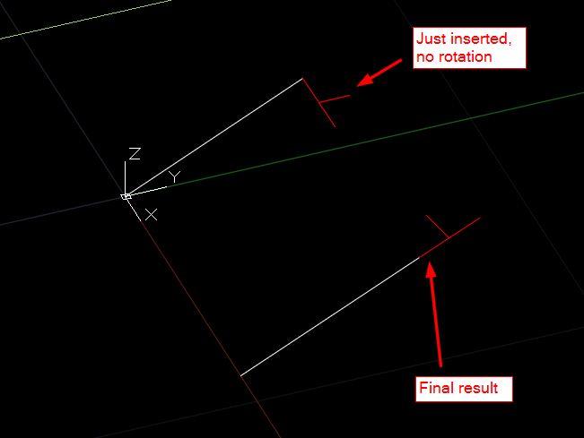

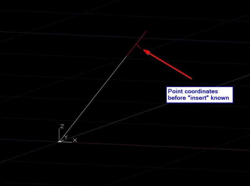

Can you elaborate a bit on that please? Have a look at the pictures below. Let us assume the red lines are a block inserted where they touch the white line. The block needs to be oriented as shown in the pictures, aligned with the white line. The insertion point as well as the three angles the block needs to be rotated are all known. How could I accomplish that without the use of command calls to standard Autocad commans? The only way I found is to use Lee Mac's routine "rotateobject" (link in my post Nr. 6 above) but that requires to define an axis and I m having problem defining an axis perpendicular to the plane defined by the white line and perpendicular to the xy plane. The other two rotation are easy, one around z and one around the white line.
Any help would be appreciated.

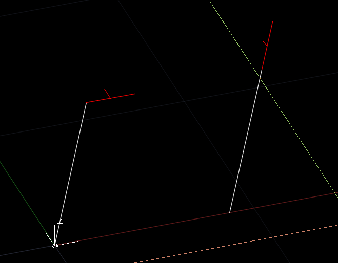

First picture is same as second. I only included two from different perspective to make it easier to understand the orientation of the model.
It would be also nice if you attached your DWG with those 2 blocks...
But from my perspective, theoretically, you'll need to multiply 2 matrices to get correct transformation matrix... Multiplication should be performed in correct order (matrix of transformation x matrix of current block orientation and position) - order must always be reversed of actual procedure of transformation... When you get correct matrix, it's not hard to apply my (c:transform) example to desired block/entity... But the problem what I see here is how to determine correct transformation matrix... Maybe if you could write down what commands would you use to get the result, then you could create those transformation matrices according to commands you used, but to get final one, remember that you must multiply them one by one in reversed order of actual order you would apply those commands...
The drawing was just an example. I didn't even save it. Just a line from 0,0,0 to 3,4,5 in WCS. The red lines are drawn on xy plane and brought up to point 3,4,5. But for the sake of the example, consider the red lines a block. The commands I use is
(command-s "_.ucs" "_3p" pt1 pt2 pt3)
where pt1 and pt2 are the two ends of the white line and pt3 is the free end of the short red line coming perpendicular to the other red. Hope that's clear.
According to your posted picture, try this :

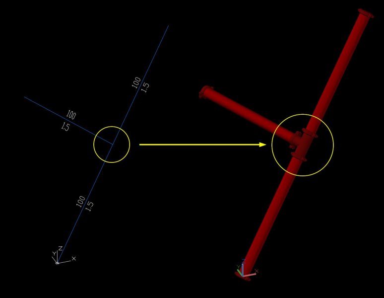

First point is that in your images you seem to be in WCS. I don't know how and when the lines are created. You originally said that you stopped using entmake because it wasn't "respecting" ucs, and another thing that I don't know is if the UCS have anything to do with the line. From the images I think it is correct to assume that the line represent the X axis for the insert, but from an UCS we could extract the Y axis as well. It is hard to provide a working solution (or anything) when we don't have the complete picture of what is needed, the steps taken. ie: yes you "have problem defining an axis perpendicular to the plane defined by the white line and perpendicular to the xy plane", because mathematically speaking you can't. An infinity of planes can be defined by one line from 0,0,0 to 3,4,5, (even if we say that that line corresponds to the X axis) but none that a Z axis would arrive perpendicular to the world xy plane (or any other). Parallel to Wxy plane, maybe, however you would have some exceptions in which a single orientation would be impossible to calculate, like with a line from 0,0,0 to 0,0,1. If you were to take that as the X axis of the block, for any given orientation of the block both the Y and Z axis would remain parallel to the Wxy plane.
You say the 3 angles the block needs to be rotated are known. You calculated them using coordinates? Long story short, you need 3 points. The line only gives you 2. You have to determine the 3rd one somehow. Once that is done, you can establish a coordinate system. The tip of the line is the origin, the extension of the line give the X axis. The 3rd point gives either the Y or Z axis. From there you can calculate the missing one. When you have the Z axis, you can calculate the OCS vector (inserts dxf 210). With the OCS vector, you can trans the insertion point from WCS to OCS (dxf 10), and calculate the rotation of the insert comparing the angle between x axis and the trans of the point 0,1,0 (dxf 50). Then you can feed that directly to your entmake/entmakex to get the desired result right away. OCS can be painfull, but hey! Food for thoughts. :)

In my model the tip of the block is known (see image). How could that be fed as a variable to orient it as desired?
I would suggest that you always insert block in 0,0,0 with rotation 0.0... Then you only have to apply correct matrix that represent your new position/orientation coordinate system, and for finding that matrix I suggest that you look into my second example... You need to visualize relation of new block position/orientation with WCS main CS as you've inserted block just in WCS origin with angle 0.0, so basically your block has matrix ((1 0 0) (0 1 0) (0 0 1)) - ((Xaxisort Yaxisort Zaxisort)), but in transformation matrix that's transposed : ((XcoordXaxisort XcoordYaxisort XcoordZaxisort Xcoordorigin) (YcoordXaxisort YcoordYaxisort YcoordZaxisort Ycoordorigin) (ZcoordXaxisort ZcoordYaxisort ZcoordZaxisort Zcoordorigin) (0.0 0.0 0.0 1.0))... So if block is in WCS and has WCS matrix ((1 0 0 0) (0 1 0 0) (0 0 1 0) (0 0 0 1)), you need to find new matrix using scheme of transformation matrix 4x4 matrix according to my description of coordinates of orts and origin... When you find that matrix either using vector calculus like my second example or multiplication of matrices in reversed order than you would apply them like in my first example, you just have to apply it to that block with (vla-transformby (vlax-ename->vla-object block) (vlax-tmatrix matrix))... I hope it's clear enough, and for orientation of while line - it's just simple vector ort (unit (mapcar '- ptpos '(0.0 0.0 0.0))) and that's equal to just (unit ptpos), so you don't need to know angles of that white line - everything is defined by vector ort coordinates in 3d space...
Understood, more or less in theory, although it s been quite many years since the last time I was dealing with vector theory. The issue here is that this matrix must be generated based on specific topology and orientation. Take a look at the picture below where you can see my intent. The 'tee' in the circle (right) will need to get oriented in accordance with the perpendicular line. But that would need to define the rotation angle around the main line (white line in my previous post).
2017-10-09 19_49_03-Autodesk AutoCAD 2017 - [3D_Drawing1.dwg_2 - Read Only].jpg
