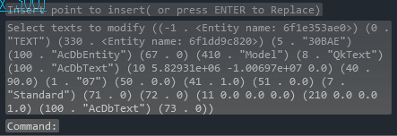

Command prompt - to stop additional display
How can I control the display of additional prompt display
What do you want to control?
Text above the ward Command:
The image appears slightly odd, not the usual command line layout for AutoCAD, but in AutoCAD you can normally hover over the top edge of the command bar and when the cursor changes alter the height of the box!
You could always shrink your command line to display only three lines of text.
I need to stop display of texts inside the red box.
Thanks . when I increase to display 3 lines the problem solved.
Click on the tool to the left of the command line and then "Lines of Prompt History"
Why don't you dock it at the bottom of the drawing frame. It stops the auto expanding then.
