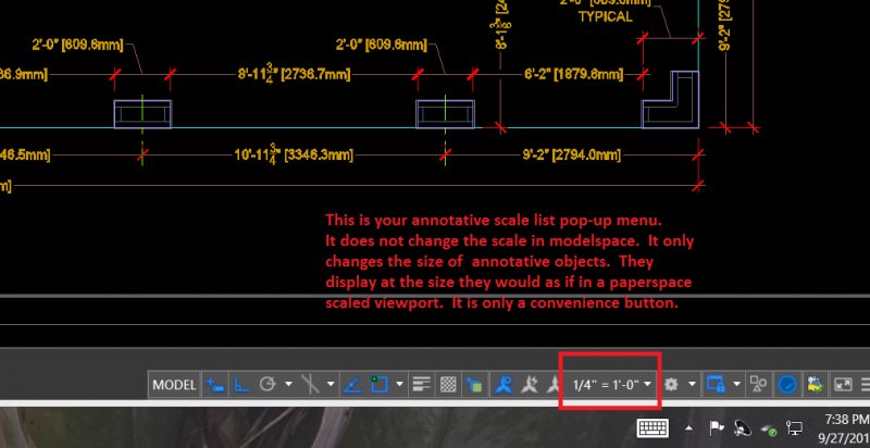

Dana W Posted September 27, 2017 Posted September 27, 2017 (edited) What exactly is it that defaults to 1:100? Are you working in modelspace or paperspace layouts? Modelspace does not default to a scale. It is always 1:1. However, since 2007 you can change the annotative view scale in modelspace, but that only changes how your annotative objects look when they change to the new "view scale". That mechanism was put in place so you can see what your annotative dimensions and such look like, at scale, before you place them in a viewport scaled in paperspace. If you are not using annotative dimensions and text, and such, then changing the annotative view scale in modelspace does nothing at all. Edited September 28, 2017 by Dana W Quote
