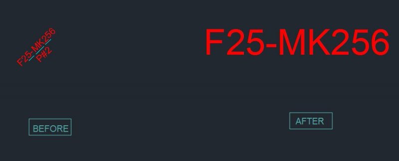

I require a lisp file to convert the block to Text in required format(as shown in attached Picture). actually i have lots of blocks in my drawing,all to be converted to the below shown format, previous i am doing manually as in below shown steps
1. block edit
2. removing the cyan line & text below to it inside block editor,
3. changing the font height to 2.0 & style as Arial
4. exiting block editor
5. using ATTSYNC command to reflect the changes made in all blocks,
6. select simillar all blocks & making rotation to 0 degree.
Also attached .dwg with this, please help me.
Thanks,
Amb.
