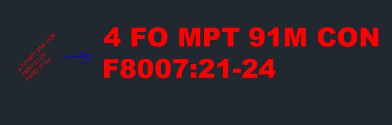

Hi Friends,
I require a lisp file to convert the block to Text in required format(as shown in attached Picture). actually i have lots of blocks in my drawing,all to be converted to the below shown format, previous i am doing manually as in below shown steps
1. block edit
2. removing the third line text (f8007:21-24).
3. changing the font height to 2.0 & style as Arial Black
4. exiting block editor
5. using ATTSYNC command to reflect the changes made in all blocks,
6. select simillar all blocks & making rotation to 0 degree.
Also attached .dwg with this, please help me.

Here's some commented code... please take some time to study it.

Download the code again from above .. I transposed a function :oops:.
Hi Ronjonp,
Thank you so much for your help, its working absolutely fine now,
Could you please send me the dxf codes if possible, i am so eager to learn these kind of codes

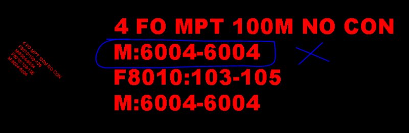

Hi Ronjonp,
some of the blocks contains 5 lines(as shown in attached file), which i have not noticed it earlier,sorry for that..
All the blocks contains 3 lines are working fine with your lisp.
could you please help me on this.
I tried editing (setq c (substr c (+ 2 i)))
but its not happening, please help me.
Actually concept is i want to keep the mtext with 3 lines after completion, ( 1st line starts with 4 FO...... 2nd line starts with F8010:...... 3rd line starts with M:600......)
if block with 3 lines, i need first 2 lines,
if the block with 5 lines, i need 3 lines(including M:600.....)
hope you understand my requst, please help me as its urgent.

Hi Ronjonp,
i have tried with replacing (strcat a "\\P" (vl-string-subst "\\P" "\n" c)) ............but its not happening, its working fine with 3 lined block, but not with 5 lined block, please check the attached image, i want that blue crossed line (M:6004-6004) to be removed. Please help.
Try this .. it assumes that you always want the last two lines if greater than 2 ...

Hi Ronjonp,
its working fine now for both kind of blocks, but the block is appearing in behind after conversion also,
please check the attached image.
Hi Ronjonp,
hi Ronjonp,
kindly ignore the above ask, its absolutely working fine now, thank you so much for you Help,
Much Appreciated!!!!
