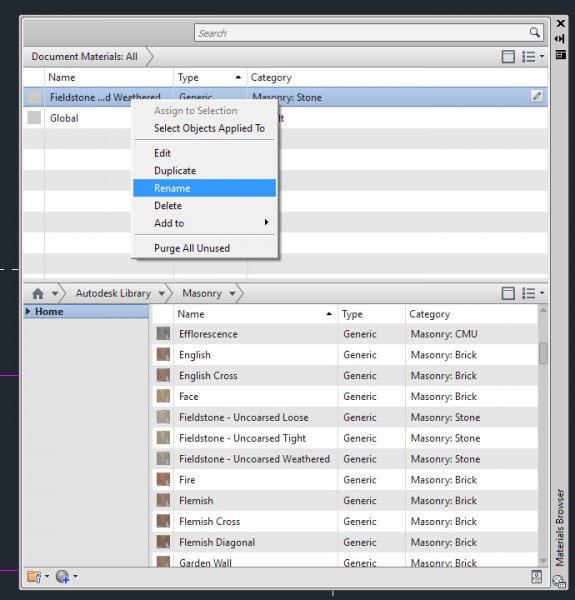

PURGE worked well. Still cant rename. I am use to duplicating with a lot of programs and then you can edit but do not see that option. Many programs do not let you rename stock items. Never really used autocad for this before. Mostly just 2D with lots of layers. You can see rename option with the right click grayed out. https://imgur.com/a/Y8JnH
You have to add the material to your drawing before you can rename it.
