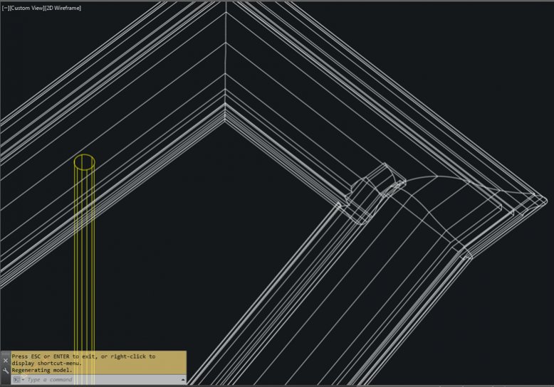

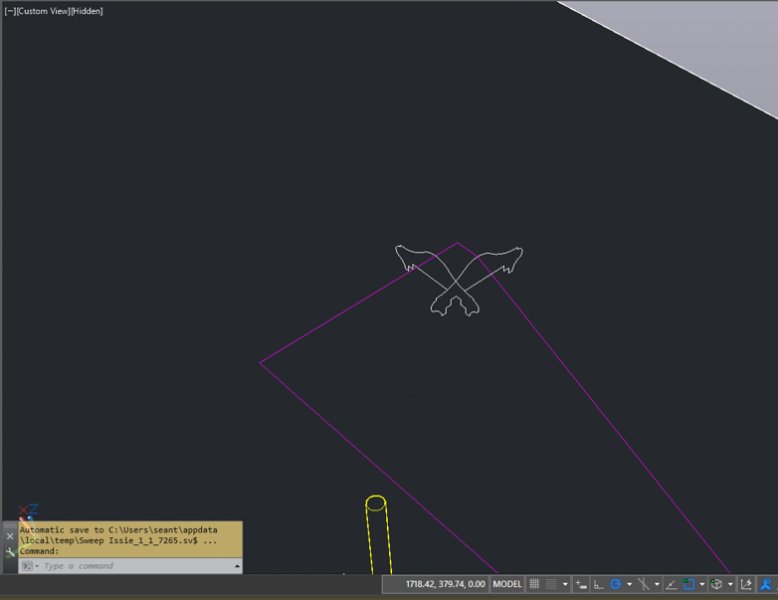

Bill Tillman Posted October 19, 2017 Posted October 19, 2017 I have laid out the attached 3D model which will have a handrail follow it's profile. In spite of all my efforts, I cannot seem to get the handrail section to sweep or extrude along the 3DPolyine I constructed. This 3DPolyline follows where the centerline of the top of the handrail will run. I could probably break the 3DPolyline into several sections and this would work, but I'm wanting to understand why it will not work as I have it now. The 3DPolyline is in the Construction Lines layer and is magenta. Sweep Issie.dwg Quote

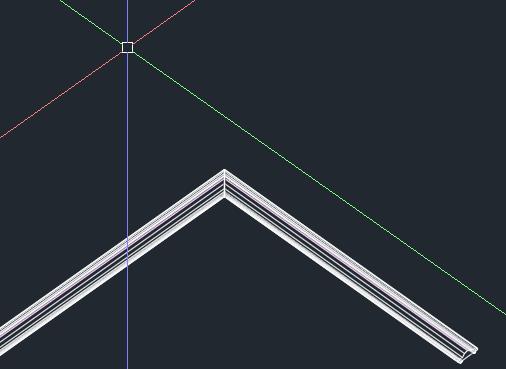

SEANT Posted October 19, 2017 Posted October 19, 2017 Does the design allow you to increase the lengths of your transitions. My guess is that there would be self intersecting geometry otherwise. SweepWtihoutIssue.dwg Quote

SEANT Posted October 21, 2017 Posted October 21, 2017 Apparently some versions of AutoCAD will allow for the sweep. Perhaps they shouldn't, though. The sweep with the original polyline can't possibly happen with such a short transition. And even when AutoCAD allows the sweep, as in SLW210's drawing, the resultant solid has voids, not to mention serious fabrication issues. Quote
BIGAL Posted October 21, 2017 Posted October 21, 2017 (edited) I started to get same problems as Seant and just read his post was about to say you would need arcs with a min radius equal to the edge distance, If you want your shape then you would have to extrude each section and slice the 45 join but then it would need a vertical angle to be included as well 1/2 angle of rise. As soon as I went away from say a circle it stopped working 2016. In civil works this occurs with slope batters in 90 corners get weird answers. An old house builder told me once about working out compound cut angles for timber being young did not listen. Bill what you need is say some cut plane routines looking at your stairs the 1st is easy a simple +- 45 cut, the second is a 0 cut but 1/2 incline angle 3rd - 1/2 incline angle plus a 45 +- and so on. Found it from Autocad help Use the SLICE command to slice a 3D solid or surface, you must specify a cutting plane or select a surface. By 3 points. You know the 3d pline vertices so using 3 pts should be able to work out all the angle variables, adding the shape to the vertice point and extruding at correct angle and length. pline co-ords-3d.lsp Edited October 21, 2017 by BIGAL Quote
BIGAL Posted October 21, 2017 Posted October 21, 2017 Bill had a play its raining so a bit of time. Run 1ststep and pick 3 points the code example is only for same Z rail. Then extrude the handrail past the intersection point on two sections so they overlap. Then run 2nd step it should do a 45 mitre for you. Union 2 halfs. Obviously need the next step and thats an incline plane to take into account hand rail rise. Need some more polar pts. (defun c:1step ( / ) (setq dist 50.0) ; change this to suit (SETQ ANGBASEE (GETVAR "ANGBASE")) (SETQ ANGDIRR (GETVAR "ANGDIR")) (SETQ LUNITSS (GETVAR "LUNITS")) (SETQ LUPRECC (GETVAR "LUPREC")) (SETQ AUNITSS (GETVAR "AUNITS")) (SETQ AUPRECC (GETVAR "AUPREC")) (SETVAR "LUNITS" 2) (SETVAR "ANGBASE" 0.0) (SETVAR "ANGDIR" 0) (SETVAR "LUPREC" 0) (SETVAR "AUNITS" 0) (SETVAR "AUPREC" 0) ) (setq pt1 (getpoint)) (setq pt2 (getpoint)) (setq pt3 (getpoint)) (setvar "osmode" 0) (setq ang1 (angle pt1 pt2)) (setq ang2 (angle pt3 pt2)) (setq horang (/ (+ ang1 ang2) 2.0)) (setq pt4 (polar pt2 horang dist)) (setq pt5 (polar pt2 (angle pt4 pt2) dist)) (setq pt4top (list (car pt4)(cadr pt4)(+ (caddr pt4)dist))) (setq pt4bot (list (car pt4)(cadr pt4)(- (caddr pt4)dist))) (setq pt5 (list (car pt5)(cadr pt5)(- (caddr pt5)dist))) (alert "please extrude objects") ) (defun c:2ndstep ( / ) (setvar "osmode" 512) (setq obj (entsel "pick 1st extruded object")) (setq ppt (cadr obj)) (setvar "osmode" 0) (command "slice" obj "" "3" pt4top pt5 pt4bot ppt) (setq obj (entsel "pick 2nd extruded object")) (setq ppt (cadr obj)) (setvar "osmode" 0) (command "slice" obj "" "3" pt4top pt5 pt4bot ppt) (SETVAR "LUNITS" lunitss) (SETVAR "ANGBASE" angbasee) (SETVAR "ANGDIR" angdirr) (SETVAR "LUPREC" luprecc) (SETVAR "AUNITS" aunitss) (SETVAR "AUPREC" auprecc) ) Quote
