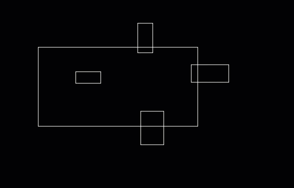

i need to know how to do that via lisp
a selection set of 3 closed polylines to 1 merged polyline
these closed polylines may have arcs , bulges or circular segments
thanks and best regards
It looks more like you are just creating a border around them not merging them. Have you looked at Lee Mac's Outline Objects lisp routine?
Lee Mac's Outline Objects lisp work only with the intersected polylines and leave the inside polyline as is
Then you are two thirds of the way there aren't you? Find a way to delete the orphan and you are good to go.

thanks , Grrr this worked for one set of intersections ... but i have multiple sets of intersections .. i will try to find a way to handle that
Convert all items to regions then use the union command.

thanks , Stef ... that's worked like a charm

RECUNION : merge any closed polyline, circle also
REVUNION : RECUNION + REVCLOUD
REVMI : REVCLOUD mirror (for REVUNION unintended direction)
