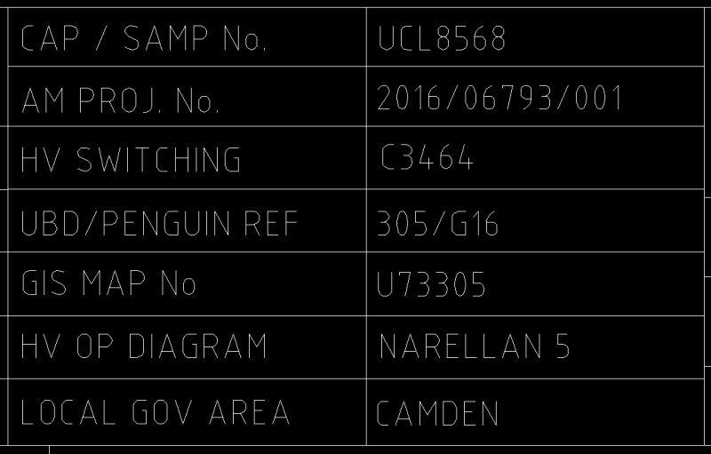

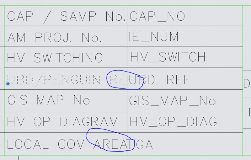

harrydang Posted October 23, 2017 Posted October 23, 2017 Hi guys, I am working on CAD 2011 LT. Yesterday, I was working on my drawings and just realized that all the fonts size changed bigger:o (please see the attached photo). I already check the width factor =1, height does not change (2.5). I didn't change the style either. . Please experts! Quote
harrydang Posted October 24, 2017 Author Posted October 24, 2017 Can you post the drawing? Hi SLW210, Thanks for your response. Please find the attached drawing in the link below: https://www.dropbox.com/s/9a8feztnac3zba5/Drawing_Probs%20need%20to%20be%20fixed_20171025.dwg?dl=0 Quote
SAFeSTeR Posted October 25, 2017 Posted October 25, 2017 Did you insert the frame or block into another drawing? If 2 separate drawings have a text style with the same name, then the block will take on the parameters of the drawing it is inserted into. Quote
SLW210 Posted October 25, 2017 Posted October 25, 2017 I can't access dropbox at work, can you post the .dwg here? We just need enough in the drawing to see what's happening. I have moved your thread to the AutoCAD 2D Drafting, Object Properties & Interface Forum. Quote
harrydang Posted October 25, 2017 Author Posted October 25, 2017 Did you insert the frame or block into another drawing? If 2 separate drawings have a text style with the same name, then the block will take on the parameters of the drawing it is inserted into. Yes, I did insert a few blocks from different drawings but the frame as I used to do. However, I already made sure that all the blocks have the same name and text style. Not sure what it's caused. Quote
harrydang Posted October 25, 2017 Author Posted October 25, 2017 Hi SLW210, Here we are Drawing_Probs need to be fixed_20171025.dwg Quote
SLW210 Posted October 26, 2017 Posted October 26, 2017 Seems fine here. I'll play around with it later today if I have time. Quote
SAFeSTeR Posted October 26, 2017 Posted October 26, 2017 Yes, I did insert a few blocks from different drawings but the frame as I used to do. However, I already made sure that all the blocks have the same name and text style. Not sure what it's caused. It's not just the name that needs to be the same, perhaps the text styles have a different font or width setting? Quote
harrydang Posted October 26, 2017 Author Posted October 26, 2017 No, the text style and width font remained the same Quote
SLW210 Posted October 27, 2017 Posted October 27, 2017 My guess is that if indeed you are running AutoCAD LT 2011 and Windows 10, it is some sort of conflict. Quote
harrydang Posted November 10, 2017 Author Posted November 10, 2017 I have found that command "attsync" Quote
