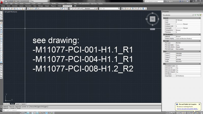

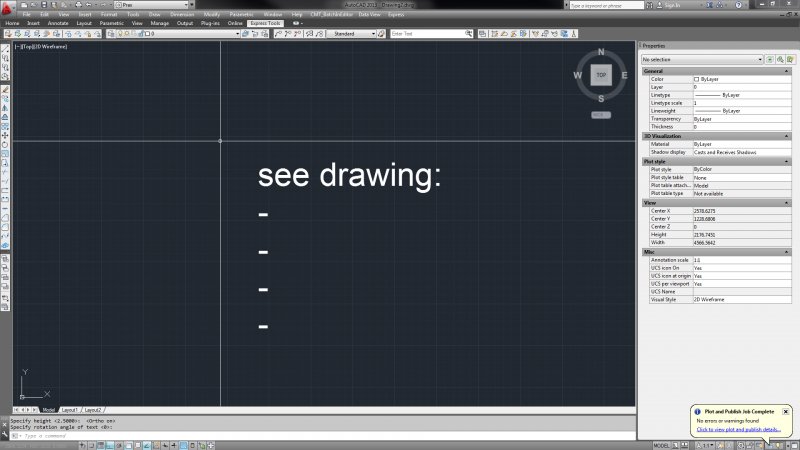

Insert those DWG's as XREF in the drawing.
Create a lisp wich creates a MTEXT with all XREF names in it?
