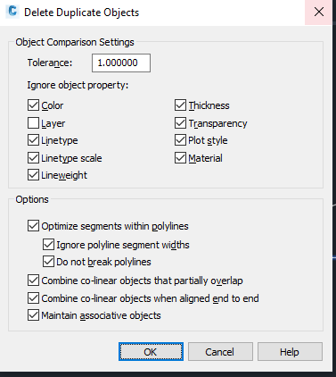

I have the same problem I want to add options in picuture to lisp (command "-overkill" (ssget "_A") "" "")
