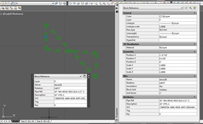

GregGleason Posted November 13, 2017 Posted November 13, 2017 I am trying to capture items on layer “0”. I first turn all layers off except “0”, but I don’t know how to code that yet so I did it manually. I am left with one object on that layer and it is a block. My goal is to window in on an area and capture the object and sent it to another layer (in this case, the layer name is “FTG-IsoCont”). I have run the following lisp and it is not able to find the block. Can someone suggest a fix? ; Changes selected objects to Layer from Prompt ; Changes selected objects to Layer FTG-IsoCont (defun c:SetWinToLayerFTG-IsoCont () (if (setq ss1 (ssget "_C" '(0.625 1.95) '(7.15 10.45) '((0 . "FTG-IsoCont")))) (command "change" ss1 "" "p" "la" "FTG-IsoCont" "") (alert "No Objects Found") );; End of if (princ) ) Greg Quote
ronjonp Posted November 13, 2017 Posted November 13, 2017 You need to use group code 8 for the layer name filter: (setq ss1 (ssget "_C" '(0.625 1.95) '(7.15 10.45) '((0 . "insert") (8 . "FTG-IsoCont")))) Quote
GregGleason Posted November 13, 2017 Author Posted November 13, 2017 You need to use group code 8 for the layer name filter: (setq ss1 (ssget "_C" '(0.625 1.95) '(7.15 10.45) '((0 . "insert") (8 . "FTG-IsoCont")))) thank you for the code snippet. But sadly it didn't work. Below is an image and some attribute data of the block. Greg Quote

ronjonp Posted November 13, 2017 Posted November 13, 2017 Read your post a bit closer, if you want to select items on layer 0 using ssget, use this instead. (setq ss1 (ssget "_C" '(0.625 1.95) '(7.15 10.45) '([b](8 . "0")[/b]))) No need to turn off layers .. that's part of the beauty of ssget filters. Quote
GregGleason Posted November 13, 2017 Author Posted November 13, 2017 Read your post a bit closer, if you want to select items on layer 0 using ssget, use this instead. (setq ss1 (ssget "_C" '(0.625 1.95) '(7.15 10.45) '([b](8 . "0")[/b]))) No need to turn off layers .. that's part of the beauty of ssget filters. That one did not work either. I'm trying to upload a .dwg. Greg Test.Object.DWG Quote

ronjonp Posted November 14, 2017 Posted November 14, 2017 Here's how I'd approach this with the example provided. (defun c:foo (/ s) (if (setq s (ssget "_x" '((0 . "insert") (2 . "block##") (8 . "0")))) (foreach x (mapcar 'cadr (ssnamex s)) (entmod (append (entget x) '((8 . "FTG-IsoCont"))))) (print "No Objects Found...") ) (princ) ) Quote
GregGleason Posted November 14, 2017 Author Posted November 14, 2017 Here's how I'd approach this with the example provided. (defun c:foo (/ s) (if (setq s (ssget "_x" '((0 . "insert") (2 . "block##") (8 . "0")))) (foreach x (mapcar 'cadr (ssnamex s)) (entmod (append (entget x) '((8 . "FTG-IsoCont"))))) (print "No Objects Found...") ) (princ) ) Thank you ronjonp! That worked! So I can learn, how is this different from the direction I went? Greg Quote
ronjonp Posted November 14, 2017 Posted November 14, 2017 Greg, The code is not reliant on coordinates to select these objects and no command calls. Be aware that if any other blocks are on layer 0, their layer will be changed as well. How did this issue arise? Your example drawing looks like it was generated by some sort of software package. Quote
GregGleason Posted November 15, 2017 Author Posted November 15, 2017 Greg, The code is not reliant on coordinates to select these objects and no command calls. Be aware that if any other blocks are on layer 0, their layer will be changed as well. How did this issue arise? Your example drawing looks like it was generated by some sort of software package. Yes, the drawing was generated by another software package. Some of which we can control before creation, but some has to be dealt with after the fact. Greg Quote
