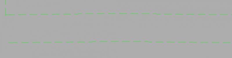

That is curious, because it works perfectly for me.
I just did the same text using AutoCAD 2018 and it worked for me. A line copied from drawing test1 to test2 and vice-versa assumed the linetype scale of the drawing it was pasted into. That's the result you are looking for isn't it?
