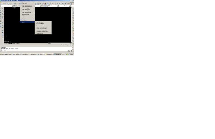

There is facility in Civil 3d to convert blocks as Civil 3D objects
I am attaching the JPEG file for your reference It may not be clear due to file restrictions on forum.
In short you can go to "Civil Points----Utilities"
Tom
