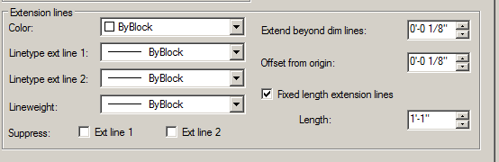

i have 2 objects. one is Rectangles and another one is crossing lines. for large number of rectangles i am suffered with manual dimension.
distance between dimension to rectangle corners is based upon "Fixed length extension lines" length. in my example file using length is 1'-1". so distance between dimension to rectangle points is 1'-1". please have a look at my sample file.
so please help with any code or macro to minimize this process like select all rectangles, cross lines and add dimensions to all rectangles.
Thank you in Advance...

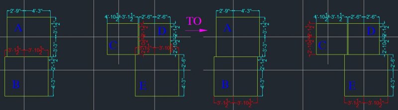

that is can you instruct to code as move dimensions to opposite vertices when dimensions and poly lines overlapped. as shown in picture, i have marked overlapped dimensions with red color. please add this rule for working more effectively.
Thank you sir.
Now where getting into the pay for it part, basically the code needs to be doubled.
It needs a response from you "flip to bottom" as the easiest way that is draw dim then erase it if wrong and redraw on opposite side. Need to redo the max min stuff for a top/bot left/right answer.
To automate a full is it touching something else is a bigger task. I offer my services for free so like many others just have to work out when to stop writing for free. Some one else may have a quick solution.
