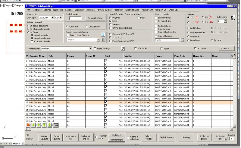

Maniac0 Posted November 28, 2017 Posted November 28, 2017 Hello everyone. I have a model with lots of sheets in it. I want to print all of them in order but printing them manually by selecting every paper as print screen is waste of time. I just want to speed up this progress. I read some other topics but coudn't understand what to do. I look some guides about ploting but coudn't find answers about my problems. At least someone can guide me to documents I have to look for auto printing those papers please? PrintExample.dwg Quote

maratovich Posted November 28, 2017 Posted November 28, 2017 (edited) No problem. We print quickly and easily. For batch printing from the model, there is a program: https://www.kdmsoft.net/revers.html Here is the image after processing, ready to print 40 pages : Edited December 21, 2017 by maratovich Quote
