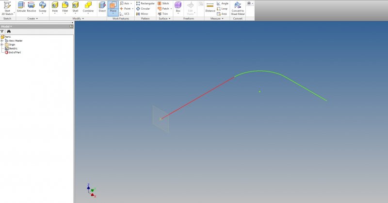

Seems like a very long winded way of doing things, I would sketch your center-line profile out.
Then create a plane to sketch your pipe size on.
click on the plane symbol, click on the end point of your sketch,click the center-line profile.

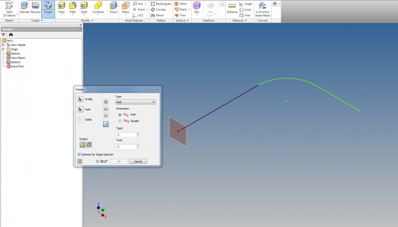

now once the sketch plane is created,start another sketch then draw your circles,dimension,finish sketch then sweep your profile along your path.
