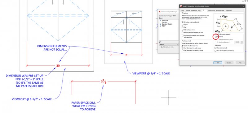

oftenly Posted December 6, 2017 Author Posted December 6, 2017 Thanks for the response, but... my questions remained unanswered. Here's a picture of what I'm dealing with (I hope it comes out alright): Those are two viewports displaying the same thing, only at different scales. The dimstyle for the model space dimensions is Standard - Model, and the paper space dimstyle is just Standard. I also played around with the settings for the viewports, ANNOAUTOSCALE and ANNOALLVISIBLE, but the dimensions do not change. What am I missing? Quote

ReMark Posted December 6, 2017 Posted December 6, 2017 Since you have failed to grasp the nuances of annotative scaling perhaps you should consider placing all text and dimensions in your paper space layout. Quote

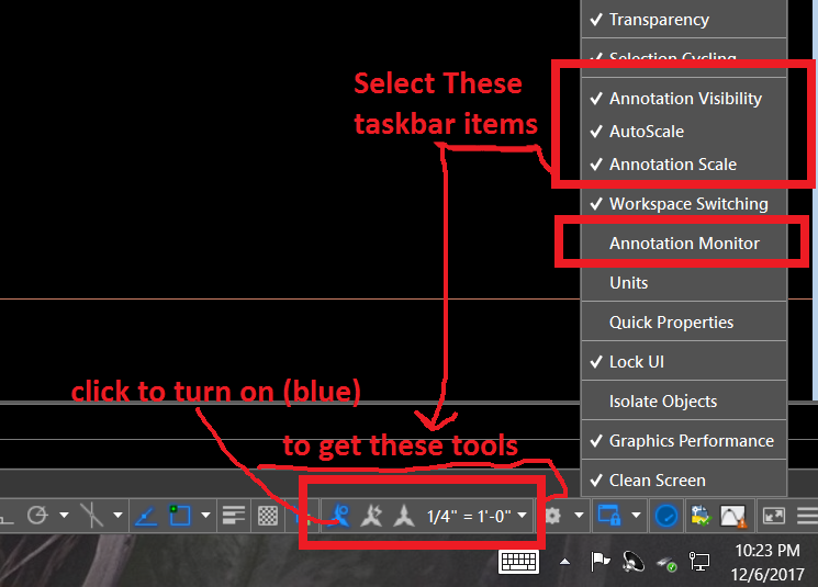

Dana W Posted December 7, 2017 Posted December 7, 2017 Annotative scaling has been around since release 2007. You've only scratched the surface of annotative objects, and blown them off too soon based on an incorrect perceived notion. Yes, annotative scales are assigned to each individual dimension, leader, and text object, and some other useful things. But, you don't have to do it yourself, although you can if you like extreme tedium. For starters, there is a pick list of annotative scales on the taskbar. It is used for changing the annotative "view" scale in modelspace. It will simulate your intended viewport scale without affecting your model geometry. Once you have picked a scale from the list, to be the "current scale", simply place new annotative dimensions or leaders or text on your modelspace objects. AutoCad applies the current scale to new dimensions automagically. If your next viewport is to be a different scale, just change the modelspace annotative view scale again. and keep on rolling. If you find that you have somehow applied the wrong scale to a group of dimensions, you can change the modelspace view scale, select the dimensions in error, and click the "Add Current Scale" button on the Annotation contextual tab. OR, you can select the error dimensions, then click the "Add/Delete" button on the same tab, and then manually add or delete scales for the selected dimensions. You can apply more than one scale to one or all annotative dimensions, and then use the same object and same dimensions in more than one viewport at a different scale in each viewport at the same time. All you have to do is apply the dimensions at one model view scale, then change the view scale, and Apply the Current Scale after selecting the dimensions. (or use the Add/Delete dialog) You can also have two or more complete sets of dimensions applied to one object, and each of those dimension sets can have a completely different annotative scale. This makes it easy to dimension one single object all at once prepping for an overall view, and one or more large scale detail views without copying, trimming, fixing, and fussing. There is WAY more to annotative scaling than this, but walking before flying is best. The only real pitfall I have found to annotative objects is what happens when they are selected. Suddenly you will see ghost images of that dimension, one for every scale assigned to that dimension. These ghost images are not all that transparent either. This can virtually obliterate the object geometry behind the dimensions, and the snap markers, making it difficult to manipulate or move a dimension. This is why I try very hard not to have more than one scale assigned to any one set of dimensions. The annotative section call-out block that comes with AutoCad is the worst for this because it is so large anyway. Annotative objects go invisible even in modelspace if the modelspace view scale is set to a scale that is not assigned to the annotative objects, just like in any viewport. There are system variables for annotative dimensioning and task bar toggles for these variables. Here's the two most used. One is very useful, the other is to be feared but can be handy ANNOALLVISIBLE = 1 will allow all annotative objects to be seen in modelspace no matter what scales are assigned to them. Those with the current model view scale assigned to them will appear at the proper size. The rest will look nasty, but in modelspace it doesn't matter. In a viewport, only dimensions with the current scale will show. ANNOALLVISIBLE = 0 will only let the annotative objects with the current scale assigned show in modelspace. ANNOAUTOSCALE = 0 DOES NOT add the new current scale to ALL annotative objects automatically when the current modelspace view scale is changed. THIS IS A GOOD THING. ANNOAUTOSCALE = 1, 2, 3, or 4 WILL automatically add the new current scale to ALL dimensions in the entire freaking drawing all at once, or parts of it, depending on the value set. This may be useful in some way that I have as yet to discover, but I currently view it as NOT A GOOD THING. Imagine selecting a few dimensions for whatever reason, and having 16 or more ghost images of them appear wiping out your ability to see what is behind them. It can be a mess. Anyway, there. You have some stuff to investigate. Believe me, any time you spend learning up on annotative scaling, can never possibly add up to all the time you've already wasted building up a pile of dimension styles just for different viewport scales. Quote
