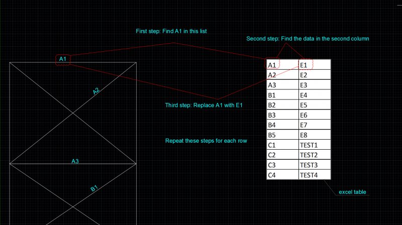

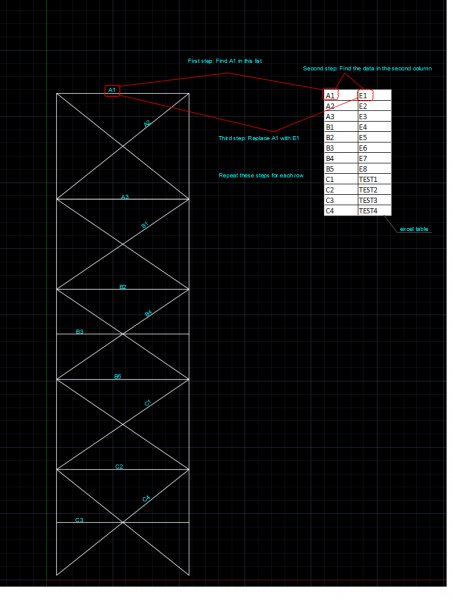

Hello,
I need a Lisp Program. This program firstly should find the texts writen in the A column of the excell in A drawing and secondly it should replace them with the texts writen in the b column of the excell.
Thanks
I did a Google and the 1st post provided a solution. You would just have to write the two columns as a csv file then use a simple csv -> list and just use a repeat reading each line and the simple defun that was in the code.
Look here at cadtutor
The dumb question did you try FIND if its not lots of text pretty quick.
Lee's version is the way to go if you have lots of dwgs. It could take into account a csv file, simpler than reading from excel. Maybe an extra option Lee ?
Thank you for your advices.
I wonder if there can be a more practical way to achieve this. Attached documents can make my aim more clear. Please let me know if you have another idea after checking this screenshot.
Thanks in advance
test1.dwg
Book1.xlsx

Actually I have a small problem.
I have a list which includes some data to be skipped because they do not exist in the drawing. I guess the code you supplied do not work in this case.
Would it be possible to modify the code so that it can find and replace the only the existing ones? Of couse I assume that It could not replace for this reason.
Thanks in advance.
TESTBook1.xlsx
Drawing2.dwg
small change to posted code...
added condition (if s (foreach txt ...
try it now and inform us...
it worked exactly how I need,
Thank you very much again :)
