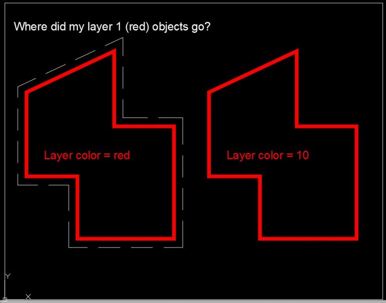

ReMark Posted December 27, 2017 Posted December 27, 2017 Bug or quirk? I'm not even sure when this first started to happen. And whenever it did I just thought I had done something wrong. But today I did some testing to confirm the above. If I assign the color "red" to a layer the objects will not display in preview nor will they plot. The particulars are as follows: -This happens in both AutoCAD 2017 and 2018. I mostly use 2018 now but I decided to also test using 2017. -Color is assigned Bylayer. -Tested in a brand new drawing. -Tested using three different printers all of which are capable of printing in color. -Object layer is not turned off nor is it frozen. -Printer icon in Layer Property Manager does not have a diagonal red line through it. -Verified that acad.ctb has properties color set to "Use object color". -Tested by assigning other colors to layer and plotting. Objects are seen in plot preview in their assigned color and they print out as well. Lastly, just for the heck of it, I created another layer and set the color value to "10" which when viewed appears to be exactly like the color "red". Copied the objects on my red layer to this new layer and changed their layer property. Plotted the drawing with the same objects side-by-side and only those on the layer assigned the color of "10" appeared in the preview and plotted out just fine. You be the judge. Did I miss something? Bug or quirk? I'm thinking quirk but I don't have a clue as to what changed. That's all folks. Quote

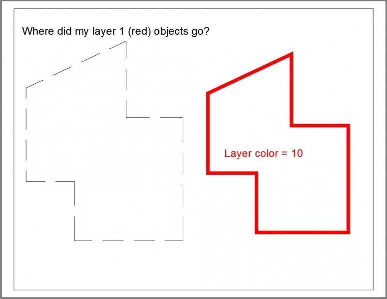

ReMark Posted December 27, 2017 Author Posted December 27, 2017 This is a screen shot of the test drawing created in and plotted from model space. And this is a screen shot of the Preview window prior to printing the drawing. Quote

eldon Posted December 28, 2017 Posted December 28, 2017 I can make out a ghost image in your picture of the Preview. Have you been playing around with the screening for colour number 1? Quote
ReMark Posted December 28, 2017 Author Posted December 28, 2017 Plotting to PDF is of no concern as I rarely if ever have a need to do so. I rarely utilize screening but I'll check the property when I fire up AutoCAD this morning. Quote
ReMark Posted December 28, 2017 Author Posted December 28, 2017 Ladies and Gentlemen....we have a WINNER! I checked the Plot Style Table Editor and the Screening value for Color 1 (red) and found it to be set to "1" instead of "100". I am not even sure when or why I made that change but thanks to eldon's good eyesight the problem is now resolved. eldon: If you PM me with your name and address I will send you enough money (U.S. dollars) to cover the cost of the first pint next time you visit your favorite pub. Thank you! ReMark Quote
