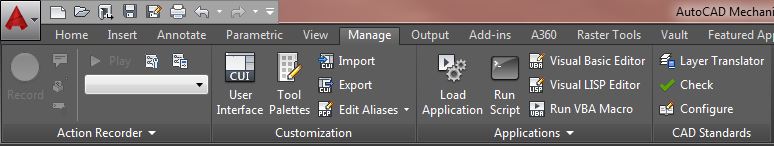

timivory Posted January 11, 2018 Posted January 11, 2018 I've created a table on a drawing and would like to sort the table based on a certain column however the STYLE & DISPLAY PANEL isn't viewable under the MANAGE ribbon. How do I get this back to being visible? Quote

timivory Posted January 12, 2018 Author Posted January 12, 2018 https://knowledge.autodesk.com/support/autocad-architecture/learn-explore/caas/CloudHelp/cloudhelp/2018/ENU/AutoCAD-Architecture/files/GUID-E8978D51-A8E6-4BFC-B522-20468CC798A7-htm.html this is the link that shows the steps to sort data within a table, but I don't have access to the panel within the MANAGE ribbon. Quote
SLW210 Posted January 12, 2018 Posted January 12, 2018 Are you using AutoCAD as per your profile or are you using AutoCAD Mechanical as per the Forum you have posted this question or are you using AutoCAD Architecture as shown in your link? From your link To Specify the Sort Order in a Schedule Table Style Products and versions covered AutoCAD Architecture 2018, & AutoCAD MEP 2018 Quote
timivory Posted January 12, 2018 Author Posted January 12, 2018 I'm using AutoCAD Mechanical 2016. Quote
SLW210 Posted January 12, 2018 Posted January 12, 2018 In that case, you do not have a Schedule Table to sort. Schedule Tables are only in AutoCAD Architecture and AutoCAD MEP and from your link it would seem the sorting is only available in the 2018 version. Quote
