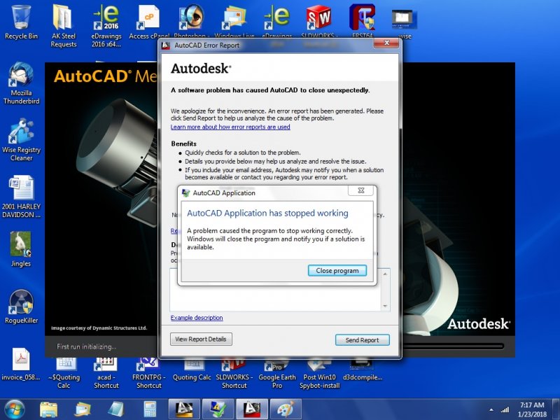

raceware Posted January 23, 2018 Posted January 23, 2018 I have a desktop with win 7 Pro installed on & had/have Autocad 2013 Mech installed on & working fine. Then I ran Wise Registry Cleaner on that came up with lots of problems which I had the reg cleaner fix. Well after the Cleaner did its job shortly after went to use Autocad & first error prompted : D3Dcomplier_43.dll missing can't find. So ent out on the web & installed the WIndows DirectX that installed the Dll file. Rebooted & attempted to run Autocad again & got error: Autocad won't start, I had got the Splash screen with First Initializing then the error. Opened Wise & restored Reg file but restoring the file didn't help same Won't Start. Reserach agin on web about the 2 stored Autocad creates when it gets registered may be corrupted to rename "*.old". Well that didn't work, so with that said I Uninstall 2013 Autocad & Fusion rebooted & re installed Autocad & Components rebooted attempted start of Autocad again same error: "won't start" splash screen comes up but never make it to register. Does anybody have a clue to fix it? Quote

raceware Posted January 23, 2018 Author Posted January 23, 2018 I'm a glutton for punishment, I have tried a "repair" no help & I supposedly did a Registry Restore but it also failed. I even could not "do a "Restore" as some how the "Restore" function got disabled & had no restore points, one issue after another. I did do an uninstall of the Autocad & Fusions & new install also to no avail, there's something I just can't find the cause of my issues. No registry Cleaners again for sure. I am trying now uninstalling all Auto desk programs I have & will address Auto desk Clean Install if anything I was doing wrong, thanks so much for the help, any further tips let me know, need all the help I can to get up & running all my drawings are in limbo! Quote

raceware Posted January 24, 2018 Author Posted January 24, 2018 I get no other error messages just Autocad can't run. I will try the Framework & Compiler suggestions. Just for FYI I use Virtual Box & I created a Win 7 Pro environment & my Autocad installed & works fine. Something I just can't find is hanging up a new install on my system I can't find. I am following instructions on the link below on a clean install from Autodesk that I'll see if it helps, although I have already tried other Clean Install procedures this one differs a little from the others. Any other tips are gratefully appreciated! Thanks https://knowledge.autodesk.com/customer-service/download-install/remove-products/remove-windows-products#Uninstall%20peripheral%20applications Quote
SLW210 Posted January 24, 2018 Posted January 24, 2018 I would look into reinstalling and/or updating or maybe rollback on the drivers for your graphics card, because Virtual Box uses it's own drivers it would bypass driver problems. Your Original problem "D3Dcomplier_43.dll" is also Graphics related. Quote
raceware Posted January 24, 2018 Author Posted January 24, 2018 Ran the DirectX informed me I had the latest, I did the Microsoft .Net uninstall & reinstall. My video driver is an old one 12/2012 Intel. About ready to try another install will be in touch! I can't thank all of you enough for the help! THANKS.................. Quote
raceware Posted January 24, 2018 Author Posted January 24, 2018 Gentlemen, GOOD NEWS!!!! I got it back & working! Thank you all so much! It must have been everything combined! Compiler, .Net, & Last Clean install ( it referenced a \Users\Public\documents\shared folder that I noticed all others did not reference to remove or just lucky ). THANKS SO VERY MUCH!!!!!!!!!!!!!!!!!!!!!!!!!!!!!!!!! Quote
