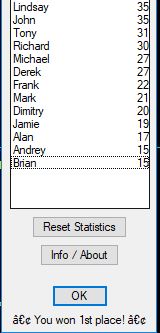

Work(draft) more and code less...
I had to do something to motivate myself to work more on the drawings and to not get distracted with coding.
So what was my solution?:
I wrote a routine that generates a ranklist and it increases my rank when I draw more (use command calls or lisp calls) - How ironic is that. :lol:
That code was fun to write(assemble) and its purpose for this is to increase the drafting productivity.
However not tested, so I don't know if the score-points are too much or less for each of the difficulties, and how addictive it would be - just wanted to realise this idea of mine.
; --- [The Drafter's Game] -----------------------------------------------------------------------------
; Drafter/Draughtsman score game
; Its using a reactor to count how many commands-calls or lisp-calls you have invoked in that drawing,
; hence increasing your score and position in the ranklist (and your drafting productivity - which is the whole purpose BTW)
; The Rank List is DWG dependent - which means individual rank per project
; Included a final boss - "The Drafter" on the < Extreme > difficulty
; Written by: Grrr
; Credits to: Lee Mac
; --- [ Technically speaking (for the lisp heads) ] -------------------------------------------------------------------------------------------------------------
; The routine uses: DCL, Reactors, Dictionaries'n'xRecords, Randomizing subfunctions
; It stores the list statistics data inside the first and only (1 . <dataL>) group code,
; located inside a xrecord in a dictionary with a name "DrafterGame", which is inside the (namedobjdict)
; So that means the Statistics/Rank List is DWG Dependent (which means individual ranklist for the different projects)
; The reactor's events and callback functions are:
; (:VLR-lispWillStart . DG:BeginLsp) (:VLR-lispEnded . DG:EndLsp) (:VLR-lispCancelled . DG:EndLsp) (:VLR-commandWillStart . DG:BeginCmd)
; The callback functions are written as simple as possible (depending on their events) - in order to prevent any slow-down of the working(drafting) process
; *DrafterGame* is a global counter variable, to not slow down the working proccess (for each event to dig into the xDictionary and subst the list.. bla-bla)
; *DGstopCounter* is a global boole variable, This boolean prevents counting command calls inside lisp routine, to prevent cases like this:
