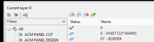

robwell Posted January 31, 2018 Author Posted January 31, 2018 I must not be understanding something. I am using AutoCAD 2018. What I am trying to do is transfer layer groups from one dwg to another. I can transfer layers by copying and pasting objects on those layers. However, I can't transfer the groups they are in to the second dwg. Maybe type a little slower for me. I am attaching a snipit of my layer manager to show what I see. There is no way to save the groups. Quote
SLW210 Posted January 31, 2018 Posted January 31, 2018 Plain AutoCAD cannot Export and Import Layer Filters, you will need to purchase a Vertical product, i.e. Civil3D or use a LISP or some other form of third party programming. Quote
