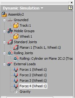

I have cylinder and plane. It is put together on tangent and flush constraints. I like to get cylinder rolling on plane and make cylinder on plane joint. Joint is ok, but both parts is grounded. See pic1.
Making some standard joint is only way to get part ungrounded? I make prismatic joint to get cylinder ungrounded, but then cylinder goes wrong place. See pic2.

are you trying to roll the wheel across the beam? there is a single constraint that you need for rotation/translation. if i can get to a computer with inventor on it i will try to get you a screen shot.

Simple rotation/translation constraint is not the same as a joint created in the Dynamic Simulation environment of Inventor Professional. With a DS joint real physics such as friction come into play.

this was my first time using inventor 09 and dynamic simulation so im sure JD will have to correct this, but I grounded my beam, put the wheel in the mobile group(right click on your part to change this). I inserted a joint, cylinder rolling on a plane then added various forces to make it roll back and forth using the input grapher.
