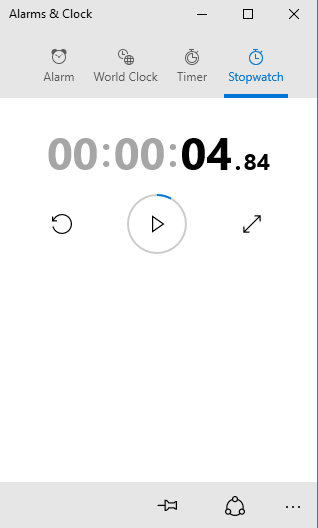

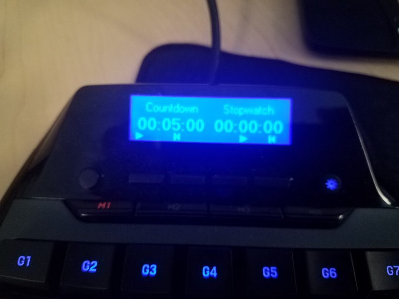

i am not sure what that really is to be honest. but i was thinking of something like a time counter. and the reason for this would be that my company harps on us so much over the time that is spent on each project.
to have when you open up an autocad file if there is a job number in the name of the file it would log it to a file just for that job number or for any cad file from the source folder so you can log your time a little more closely.being that each of out projects has a different job number, have it log time autocad was spent open with a drawing name, I.E. job number that is on the file.
this could be totally far fetched but i was thinking about this the other day. i have a logitec G13 keyboard. i attached a screen shot of the stopwatch that is on that. i can use it but it is hard to remember to hit stop and go each time. windows 10 also has one on there, just think it would be really cool to have one for autocad. that could log your time spent on a job.
