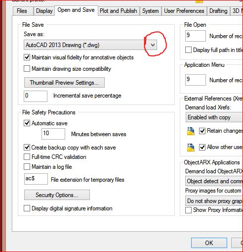

I am guessing that you won't want to make it your default SAVE filetype, but should you want to, you can do that in OPTIONS, on the OPEN & SAVE tab.
If you choose one of the numerous .dfx file types in that dropdown list, whenever you use the SAVE command, whatever you are working on will be Saved As a .dfx.
Thanks guys particularly CAD64.
