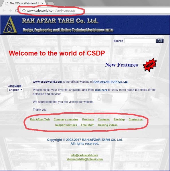

reza Posted February 26, 2018 Author Posted February 26, 2018 Hi BIGAL thank you for reply I've already used your ideas in other posts. To get to know "CSDP", go to the following address: http://www.csdpworld.com/en/home.asp Quote
pBe Posted February 26, 2018 Posted February 26, 2018 Hi pBeThank you Your advice helped me solve my problem very much Good for you, Like what BIGAL said, the process can be streamlined by starting with the original text file. Have fun coding. pBe Quote
BIGAL Posted February 27, 2018 Posted February 27, 2018 The link did not explain what your trying to do. Quote
reza Posted February 27, 2018 Author Posted February 27, 2018 Please refer to the links for more information Quote
