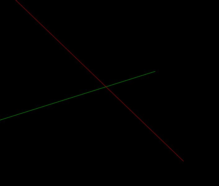

it's weird? command ALIGN applied on 2D object which is not aligned perfectly, a small gap at the end of the line!:ouch:
Is it a bug or am i wrong?

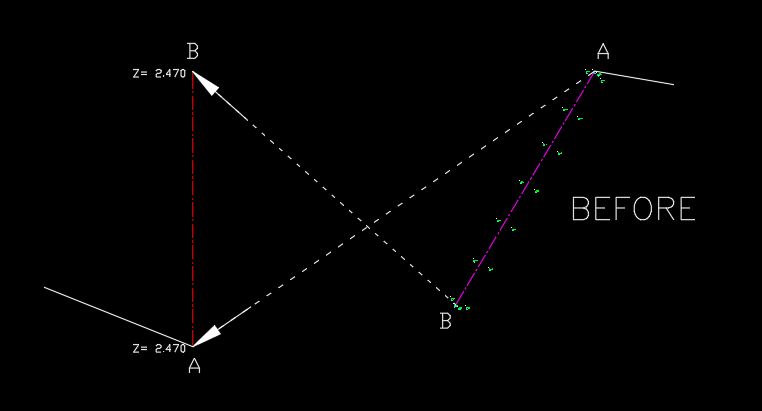

sorry for that, well let me elaborate more detail:
The magenta line is the baseline before we ALIGN to the "normal" green/red line, which 'A' is start point, 'B' end point respectively.
There are nods along the baseline, in the dwg i use attributed block to indicate their 'Z' elevation purpose only
BEFORE
The magenta line has End points At 'A' Z=82.230 & 'B' Z=82.091 (I use TEXT to indicate), so 'A'&'B' Delta Z=-0.139, the left & right Delta Z for each end at 'A'=3mm & 'B'=14mm.
AFTER
If we need to "Normalize" the nods along the magenta baseline to be aligned orthogonal at GREEN/RED line at flat elevation of Z=2.470 (Note: not fully flatten which nods are still referenced to the baseline)
Shouldn't it be (shown in GREEN line)
End points At 'A' Z=2.470 & 'B' Z=2.470 ,'A'&'B' Delta Z=0.00, with 'A'=3mm & 'B'=14mm for each end points same as before align?
But after ALIGN command (bug? shown in RED line)
i have no idea how it became 'A'=6mm & 'B'=22mm for each end points, perhaps tilted or something?
Though it fits on the flat line, ie: Delta Z=0.00
Thanks

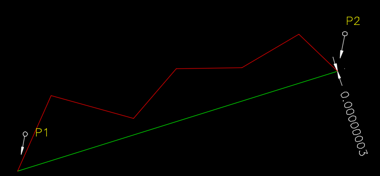

I get gaps and overlap in AutoCAD 2018 depending on the order picked. Mine seem to be closer than the OP's.
Thanks for test, however that's no issue for your "gaps" or "overlap", yours is 0.00000003 over 4k is high decimal precision it's normal.
as mine is 0.030 over 4k

I think the problem is that you are using only 2 source points and 2 destination points thus the line is "rotating" as it is being aligned and the two points are changing their relative z values.
I created a polyline from the Before A off to the right. Since it is a polyline (and not a line) the second vertex will have the same z coordinate as the first. I did the same at the After A. The lengths of these line is not important as their ends will only be used to define the XY plane of the alignment. I used the free ends of these two polylines for the 3rd source and 3rd destination points to ensure the line didn't rotate. The resulting delta z difference was 14mm which is what you were expecting.
Bottom line, this is a 3D align task due to the difference in Z! With about 16 significant figures of precision I didn't think it was an AutoCAD problem.
Thanks lrm it worked! Though it still needs 3 pairs of points,
