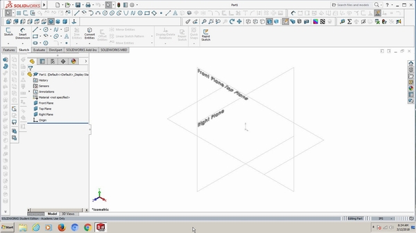

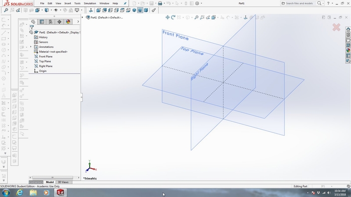

Thank you for your help gentlemen. Welldriller, I see no toggle for "Classic" GUI.
I have enclosed two screen shots for some help. I can live with Image B. If you could
please tell me how I arrive at Image B from Image A, it would be of huge help to me.
I will consult with some tutorials as well.
