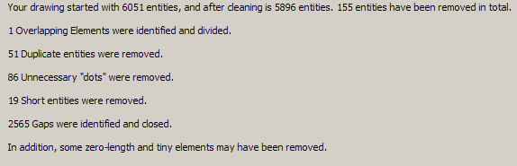

I had a lot of items that were removed when I ran it through the clean up tool for the water jet. And as stated by Cad64, it is made up of lots of lines, it looks like it was made (poorly) for some sort of cutter. What is the need for extruding?
