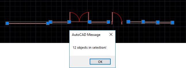

... and it only prompts me to select one rectangle, but doesn't let me make another selection to count how many rectangles, equal to the one i previously selected, are in the slection set
Not sure I understand this statement.
The code worked in the sample drawing you posted.
i think that i'm the one who's not understanding your code then =(
i meant i need to select the rectangle and then make another selection to count how many equal rectangles are there
but your code only prompts me to select a rectangle and doesn't return me anything (which variable u assigned to give me a value?)
Try replacing:
(sssetfirst nil n)
with:
(if (= 0 (sslength n))
   (alert "Nothing in selection!")
   (progn (sssetfirst nil n) (alert (strcat (itoa (sslength n)) " objects in selection!")))
thanks ron, now i'm understanding a little better what your code does
the variable n retrieves me the amount of objects
but your code is finding the rectangle in the whole drawing, i want to find the rectangle inside another selection set, is that possible?
Try this:

excellent ron!
we're almost reaching a perfect resolution for my problem
your code is working smoothly
But just so u can understand better what i need, this part of your code is not needed:
what i need is the value that the variable n is returning to me in your code!
but that's okay, i can remove this last part
