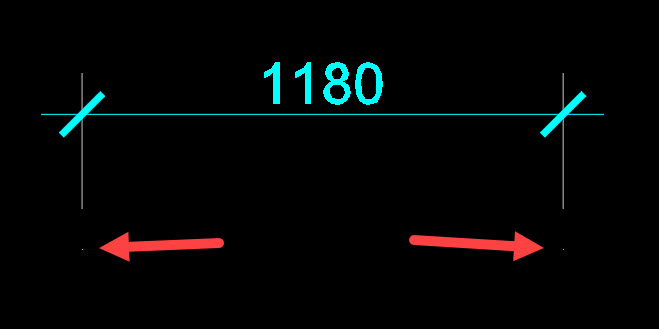

I got this LISP a long time ago and forget where it originated from.
It rounds of "FACE3D,ARC,ATTDEF,ATTRIB,CIRCLE,ELLIPSE,INSERT,LINE,POLYLINE,LWPOLYLINE,*TEXT,POINT,SHAPE,SOLID,TRACE".
But I would like it to also round of the point of dimensions so they are at the same location as the newly positioned endpoints of the lines/polylines etc.
See here what dim point I refer to.
I don't know where to start to get that working.
Thanks.
