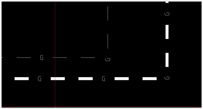

BIGAL Posted March 22, 2018 Posted March 22, 2018 Dont understand a gas line as a line or as a pline with a width ? Quote

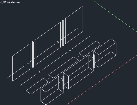

BIGAL Posted March 23, 2018 Posted March 23, 2018 Your right Remark, a line, a line with thickness, a pline with width and lastly a pline with width and thickness. Quote
Deodar311 Posted March 26, 2018 Author Posted March 26, 2018 Sorry, I don't receive notifications when someone reply's to my post. Big Al: How did you create the polyline with text and a width? I know how to set the width, but how do you add text? The 3D line was cool, but not what I am seeking. Thanks! Quote

BIGAL Posted April 4, 2018 Posted April 4, 2018 You can make the width of the line in a few ways simplest is make the line a pline and set the width, you can set a linetype width as a property, toolbar "Properties" and you set a width when you plot by using a pen thickness in a CTB which can be different than what you see on the screen. See my prior images. Quote
