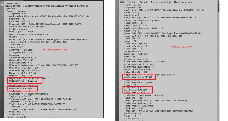

Want to read out properties of ATTDEF (nested in block )
need to know the rotation and the oblique
i did the ename entget and the vla dump
Please see result on screenshots
The rotation and oblique is both 30 but the dump shows me 0.5
And i have something like ???
:x freaking radians
0.5 radian is about 30 degrees
