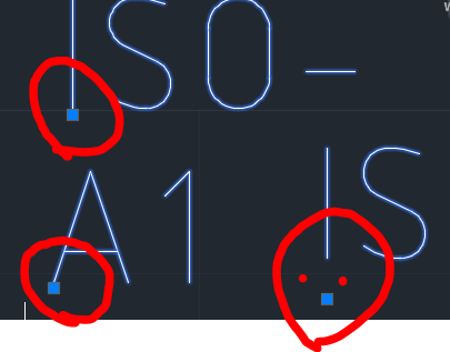

DGRL Posted April 7, 2018 Posted April 7, 2018 (edited) Dear coders Am busy playing with attributes and walked into something funny Have multiple ATTDEF'S i insert into model using lisp 2 of the 3 are aligned normal and 1 has the text hovering above the insert point All 3 of the attdefs are made with same routine and same mode ( multiline ) Does any of you know how to fix this? See attached pic Edited April 8, 2018 by DGRL Quote

DGRL Posted April 8, 2018 Author Posted April 8, 2018 attissue.dwg Here you have an dwg with few Multiline ATTDEF See the 4 circles and compare them with the others See their alignment in properties and then my initial post The code is use is simple vla-addattribute with the multi line mode acAttributeModeMultipleLine and the result is like this a few attdefs aligned with text on the blue square selection box and a few not Gr. DGRL Quote
rlx Posted April 8, 2018 Posted April 8, 2018 (edited) only difference I can see is in height and layer , 3.5 vs 3.0 , layer 0 vs 'text' so this is not logical captain, sooo , logic dictates there is only one conclusion possible : the good attributes are male and the rest is female because my wife also defies all logic... makes sense no? only other thing I can see when I wblock your 0-%-Title Block is the line spacing : text height: 3.0000 Line spacing: Multiple (1x = 5.0000) text height: 3.5000 Line spacing: Multiple (1x = 5.8333) but I guess that is to be expected? gr. Rlx Edited April 9, 2018 by rlx Quote
DGRL Posted April 9, 2018 Author Posted April 9, 2018 @rlx Thanks for taking a look You do not see the same issue as the pic in my initial post? See the difference between "Title regel 1" and the project no. "17-00000" Their alignment is the same though when selected you see the "Title regel 1" hovering and the project number not Quote
rlx Posted April 9, 2018 Posted April 9, 2018 I see the same issue. But when I explode your titleblock, all attributes are the same , bottom-left , hovering a little , and all the text entities are just plain left. So maybe you should use left aligment and not bottom-left? And why the multiline? gr. Rlx Quote
DGRL Posted April 9, 2018 Author Posted April 9, 2018 OK ok lol Why the Multiline Because I have some ATTDEFS that are multiline and they display also as multiline And try to BURST the block and see what the result is Quote
Roy_043 Posted April 9, 2018 Posted April 9, 2018 IMO the behavior you see is logical. The Multiline attribute has a bottom left alignment. If there are characters in the final line of the text that extend below the baseline, the baseline will not coincide with the alignment point. Quote
DGRL Posted April 9, 2018 Author Posted April 9, 2018 I will test this at home but it sounds logical @Roy_043 Quote
DGRL Posted April 9, 2018 Author Posted April 9, 2018 @Roy_043 I just checked in the dwg I uploaded here and removed 1 of these characters you mentioned and the text aligned how it should You are correct with what you said and I thank you for this Quote
