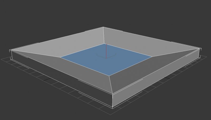

I think he wants to create something like what I'm showing below, where the center blue area is lower than the outer edges. I made this in 3ds Max, where objects like this are dead simple to create, but in Autocad, not so easy.
One way to create this object would be to make 2 solids and subtract one from the other. I'm not an expert with Autocad 3D though, so maybe someone else will have a simpler solution.

It sounds to me like three objects would be required to create this by Subtraction, since the thickness of the material is only 0.3 units, which is the same as the differential described between the inside and outer edges.
There would need to be two objects subtracted, one from above the desired part, and another from below it. :|

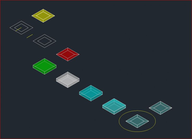

Bored, no work, I modeled it for you in Metric (mms).
I used LOFT to generate the RED subtraction bit, from the pair of concentric squares to the left, after moving the smaller square up by 0.3 mms.
I subracted a copy of that Red part from a copy of the GREEN block to generate the other subtraction bit. The GRAY piece later shown as BLUE is shown aligned properly with the other two bits, to the left of the Yellow circle, just before the SUBTRACT command, which will create the final part shown in the Yellow circle.
Probably more fluid and modern ways to do it, possibly with Surface modeling, which I have never done.
This is one old school way to go, hope it helps you. :beer:
Having not had work earlier, and being curious, I modeled this again.
I tried this time with SWEEP utilizing the PATH option. Definitely the way to go.
Screenshot is changed, as is the dwg attachment.
The yellow Solid at the top was created by sweeping the closed yellow linework along the 50x50 closed polyline.
Painless, much better. :beer:
