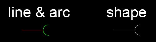

can any one help to draw the shape as in attached image

Where did you get that screenshot? If you have a DWG file with this linetype in it, then you've already got it.
I got the line in image
i draw line and half circle then repeat it
that is all

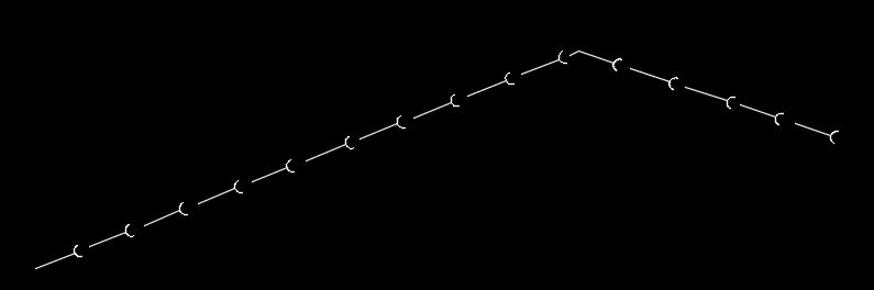

If you use a shape of the line and half circle combined to make the linetype, then when going around curves, the shape rotates individually and does not make a nice line.
There are many fonts which have the half circle in the letter C, or even a wingdings font has the half circle. Much better, but harder, is to make the linetype with a line and the character strategically placed.
This may help you make your linetype when you figure out the font.
