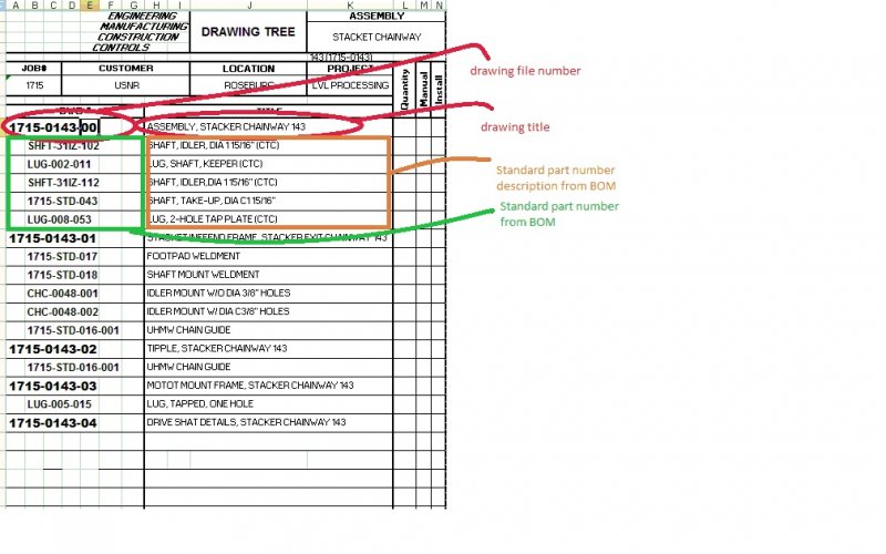

I have multiple drawings we copy drawing number, description and from each drawings, and standard part and its description from the BOM in each drawing. And then paste into Pre-formatted excel spread sheet.
1. Drawing number first, description.
2. Standard parts and its description from the BOM in each drawing.
I’m looking for a way to extract attributes drawing file number and title and to be able to extract standard parts or selected parts and description from BOM in AutoCAD drawing file from mutable drawings into pre-formatted Excel Spread sheet?

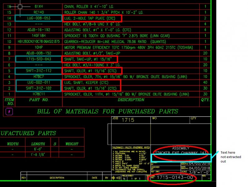

It's possible. But much depends on the title block.
Can you attach an example of the title block .dwg?
This is title with BOM that is generated by balloon command that inserts balloon and add BOM. Then you have to edit each BOM line and enter the value for each line. not very productive, but it what we have. I even uploaded the BOM.dwg and lisp routine that inserts the balloon and BOM

Had a look at your dwg and pretty straight forward. May need more than 1 function to match the task, the bom is diffrent to say titleblock.
In saying that, a method would be pick a block, pick a slection retrieve attributes either all or what you want, then do something export to csv txt file excel etc.
When you pick a block you can get at the attributes also. As a 1st step it would be extract attributes to say csv then go more advanced and put into excel cells.
Wether it be mulitiple lines of block attributes or a title block the method is the same just how many.
I am sure if you google for "title block to excel" you will find example code.
Here is something to get you started. Have your text screen displayed at same time.

tried the top code and gave me an "Pick a block ; error: bad argument type: lentityp nil".
I added the (vl-load-com) as a precaution, I just reopened your dwg and picked 3 lines in your parts list all appear in the text screen press F2 an error occurs when I pick nothing or press enter to exit. I need to tidy up the exit.
Pick a block
5 - ITEM
SHFT-31IZ-112 - PART_NO
SHAFT, IDLER, %%C1 15/16" (CTC) - DESCRIPTION
10 - QTY
Pick a block
6 - ITEM
--- - PART_NO
HEX BOLT, %%C3/4-10UNC X 3" LG. - DESCRIPTION
20 - QTY
Pick a block
7 - ITEM
1715-STD-043 - PART_NO
SHAFT, TAKE-UP, %%C1 15/16" - DESCRIPTION
10 - QTY
Pick a block
