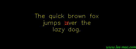

dnovember99 Posted May 11, 2018 Posted May 11, 2018 so i have been looking for some time now to try and find something that will be able to help me with this. i want to be and to have the text within Mtext to be aligned right, center or left. the only way that i can see to do that right now is to double click, highlight the text and then selection it from the ribbon. i have tried to use textalign command and that just doesnt seem to move the text to the right, center or left. anyone know of a lisp out there that you would be able to just choose left, right or center and then click the text that you want to change? thank you all Quote

Lee Mac Posted May 11, 2018 Posted May 11, 2018 (edited) Try this: (defun c:mj ( / g i l s ) (if (setq s (ssget "_:L" '((0 . "MTEXT")))) (progn (repeat (setq i (sslength s)) (setq l (cons (entget (ssname s (setq i (1- i)))) l)) ) (princ "\nAlter the alignment using the numberpad <done>: ") (while (and (= 2 (car (setq g (grread nil 2)))) (< 48 (cadr g) 58)) (setq g (cons 71 (cdr (assoc (cadr g) '((49 . 7)(50 . (51 . 9)(52 . 4)(53 . 5)(54 . 6)(55 . 1)(56 . 2)(57 . 3)))))) (foreach x l (entmod (subst g (assoc 71 x) x))) ) ) ) (princ) ) Edited May 11, 2018 by Lee Mac Quote
ronjonp Posted May 11, 2018 Posted May 11, 2018 (edited) Nice Lee .. here's another quick one. (defun c:just (/ j k s) (setq j '("TL" "TC" "TR" "ML" "MC" "MR" "BL" "BC" "BR")) (initget 0 (apply 'strcat (mapcar '(lambda (x) (strcat x " ")) j))) (cond ((and (or (setq k (getkword (strcat "\n[" (apply 'strcat (mapcar '(lambda (x) (strcat x "/")) j)) "]: <TL>") ) ) (setq k "TL") ) (setq s (ssget ":L" '((0 . "mtext")))) ) (foreach e (vl-remove-if 'listp (mapcar 'cadr (ssnamex s))) (vla-put-attachmentpoint (vlax-ename->vla-object e) (1+ (vl-position k j))) ) ) ) (princ) ) (vl-load-com) Edited May 11, 2018 by ronjonp *added all justification options Quote

Lee Mac Posted May 11, 2018 Posted May 11, 2018 Mr. Mac, thank you for this. i was playing around with it and i noticed that on the key pad (9)is bottom (6) center and (3) top and then the other side (7) bottom (4) center and (1) top. You should find that the justification is set as follows: 7=Top-Left, 8=Top-Center, 9=Top-Right, 4=Middle-Left, 5=Middle-Center, 6=Middle-Right, 1=Bottom-Left etc. This is confirmed in my testing - is this not the case? Quote

Lee Mac Posted May 15, 2018 Posted May 15, 2018 @ LeeIf that were synonymous with text, now it works only with MTexte The following should work with both - (defun c:mj ( / g i k l s ) (setq k '( (49 ((71 . 7)) ((72 . 0) (73 . 1))) (50 ((71 . ) ((72 . 1) (73 . 1))) (51 ((71 . 9)) ((72 . 2) (73 . 1))) (52 ((71 . 4)) ((72 . 0) (73 . 2))) (53 ((71 . 5)) ((72 . 1) (73 . 2))) (54 ((71 . 6)) ((72 . 2) (73 . 2))) (55 ((71 . 1)) ((72 . 0) (73 . 3))) (56 ((71 . 2)) ((72 . 1) (73 . 3))) (57 ((71 . 3)) ((72 . 2) (73 . 3))) ) ) (if (setq s (ssget "_:L" '((0 . "TEXT,MTEXT")))) (progn (repeat (setq i (sslength s)) (setq i (1- i) x (entget (ssname s i)) ) (if (and (= "TEXT" (cdr (assoc 0 x))) (= 0 (cdr (assoc 72 x)) (cdr (assoc 73 x)))) (entmod (setq x (subst (cons 11 (cdr (assoc 10 x))) (assoc 11 x) x))); (subst '(73 . 1) '(73 . 0) x))) ) (setq l (cons x l)) ) (princ "\nAlter the alignment using the numberpad <done>: ") (while (and (= 2 (car (setq g (grread nil 2)))) (< 48 (cadr g) 58)) (setq g (cdr (assoc (cadr g) k))) (foreach x l (foreach y (if (= "MTEXT" (cdr (assoc 0 x))) (car g) (cadr g)) (setq x (subst y (assoc (car y) x) x)) ) (entmod x) ) ) ) ) (princ) ) Quote
