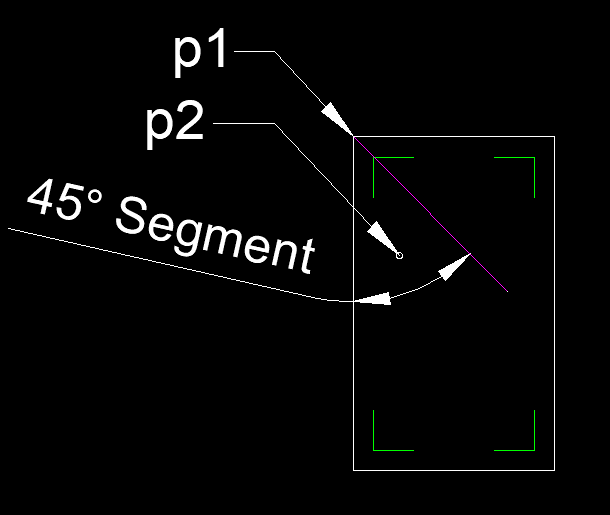

After I pick my dimension point I will pick a point at about say about 20 degrees. Then what I'm trying to say with the first "IF" statement is that if p2 is somewhere between 0 deg and 45 deg then my "SETQ" will give me a direction to draw my line later in the program. I will probably have 8 "IF" statements to cover all 45 deg segments in a circle.
For some reason the if statement won't work. I've tried many combinations with no luck.
Can somebody steer me in the right direction???
Regards
Tony
(setq p1 (getpoint "\nPick a dimension point:")
       p2 (getpoint p1 "\nPick a location point:"))
(setq ang (angle p1 p2))
 (if (and (> (rtd ang) 0) (< (rtd ang) 45))
   (setq direction (polar p1 (dtr 0)))
 (if (and (> (rtd ang) 45) (< (rtd ang) 90))
   (setq direction (polar p1 (dtr 90)))

You have omitted one argument with your polar function.
(polar pt ang dist)
The angle is returned in radians so 45=0.7853981633974483 or (* pi 0.25) or (setq a45 (* pi 0.25)) and use a45 its just me rather than using the rtd function all the time.

Use a condition statement otherwise it will always evaluate all 8 "if's"
 (cond ( (and (> (rtd ang) 0) (< (rtd ang) 45))
         );end sub
          ( (and (> (rtd ang) 45) (< (rtd ang) 90))
         );end sub
         etc....
          ( (and (> (rtd ang) 270) (< (rtd ang) 315))
            (setq direction (polar p1 .......)
          );end sub
          ( t                             ;will only get here if angle > 315
            (setq direction (polar p1 ......)
          );end sub
 );end_cond
As soon as it finds a condition it satisfies it will exit the (cond). It also allows multiple lines of code in each sub without having to use progn:celebrate:

I'm really frustrated with this one I just can't quite get it right. If you look at the attachment you see 8 green lines. Using the code below I want to draw only 1 line but it could be any of these positions so I thought if I picked a corner (p1) and then another point in the 45 deg segment (p2). I could setq 2 points based from the corner point. The line is 2mm long and is 1mm in the x & y from the corner.

See above. Angles of exactly 0 45, 90, 135 etc never meet any condition

Thank you very much for all the input It now works absolutely perfect.
Do you think it's a bit long winded. I am an amateur of course.
Sorry Frank I didn't get to try your method. I'm sure it works fine to.
I had to turn the Osnaps of because it wasn't consistent with them on.

Looks OK, :pumping: you don't really need this
( (and (>= (deltartd ang) 315) (< (deltartd ang) 360))
       (setq StartPt (polar p1 (deltadtr 315) 1.412))
       (setq EndPt (polar StartPt (deltadtr 0) 2.0)))
it could be written as :
( t
since anything reaching this point will be >= 315. Everyone has their own coding style. Leave it as it is to be safe.:pirate:

Unless I've misunderstood, I think the code could be reduced to something like this:
(defun c:ref ( / a1 p1 p2 )
   (and (setq p1 (getpoint "\nPick a line reference point: "))
        (setq p2 (getpoint p1 "\nPick a location point: "))
        (setq a1 (angle p1 p2)
              p1 (polar p1 (- (LM:roundm (+ a1 (/ pi 4)) (/ pi 2)) (/ pi 4)) (sqrt 2))
        (entmake (list '(0 . "LINE") (cons 10 p1) (cons 11 (polar p1 (LM:roundm a1 (/ pi 2)) 2))))

not sure?
(defun c:ref2 (/ p1 p2 a r cur )
 (and (setq p1	  (getpoint "\nPick line reference point.. ") )
      (setq p2	  (getpoint p1 "\nPick line destination point.. ") )
      (setq r    (distance p1 p2))
    (while
 (and (setq cur (grread t 13 0)) (= (car cur ) 5) )
 (redraw)
 (setq p2 (cadr cur)
       a  (angle p1 p2)
       p2 (polar p1  (- a ([color="blue"]rem[/color] a (* 0.25 pi))) r )
    (grdraw p1 p2 1 1)
happy weekend :)
