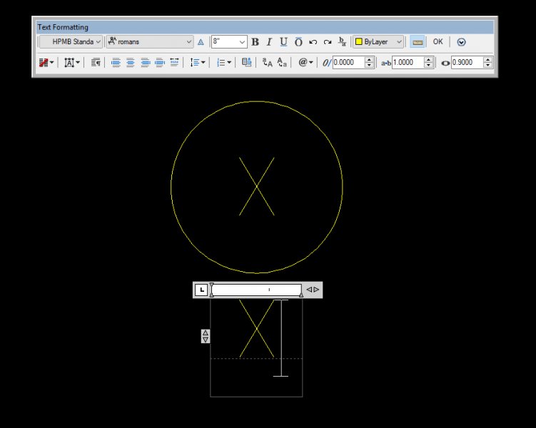

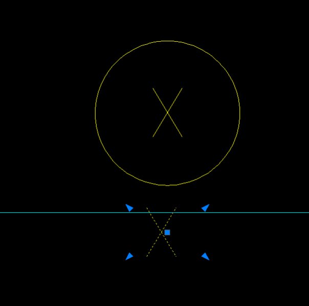

Samr79 Posted May 23, 2018 Posted May 23, 2018 I'm using AutoCAD 2012 and in the drawing I am working in when I double click into MTEXT to make edits, the text shifts to the right. After the edit it shifts back to the left and looks off when lined up with my bubble notes. What might cause this. Quote

dlanorh Posted May 23, 2018 Posted May 23, 2018 Type "attsync" on the command line, choose select from the list that pops up and select one of the block. They should all re-align to centre. FYI the Middle Centre of the text is not at the centre of the bubble. Quote
